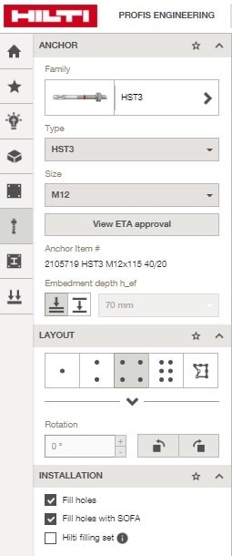

Anchor arrangement
An error was pointed out saying the bolts arrangement is not correct, and suggested to use SOFA fill hole
SOFA with fill,anchors arrangement

Posted by XING CHENabout 4 years ago
How to activate SOFA function, please!
Posted by Tobyabout 4 years ago
Hi Mr. Chen,
Thank you for your enquiry.
Please find the attached capture by clicking on and selecting the Fill holes with SOFA button to activate the SOFA function for further calculation.
