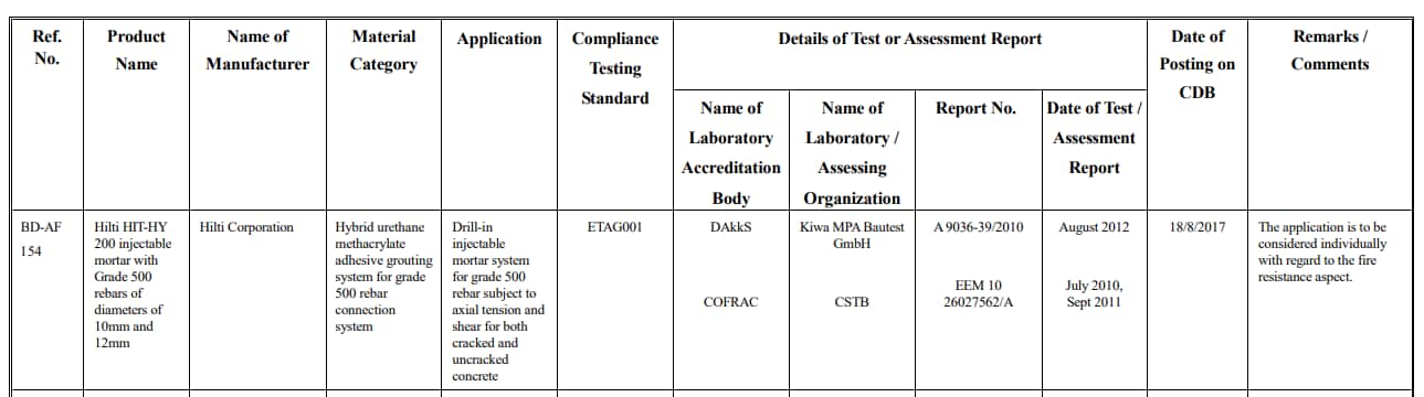

I am working on a Hong Kong project and intended to use the BD pre-approved structural fixing Hilti HIT-HY 200 injectatble mortar with Grade 500 rebars of Y10 and Y12.
I would like to have more information, such as required embedment depth, design capacity against tension and shear.

Thank you for your enquiry. Please find the below link for the general information of HY200-R with rebar in post-installed rebar system (concrete to concrete connection).
https://www.hilti.com.hk/medias/sys_master/documents/h59/hb6/9882291470366/Submittal-ASSET-DOC-LOC-8709175.pdf
The actual embedment and loading capacity should be checked based on different cases. Please feel free to send us your case's details at TeamEngineering.HK@hilti.com.
