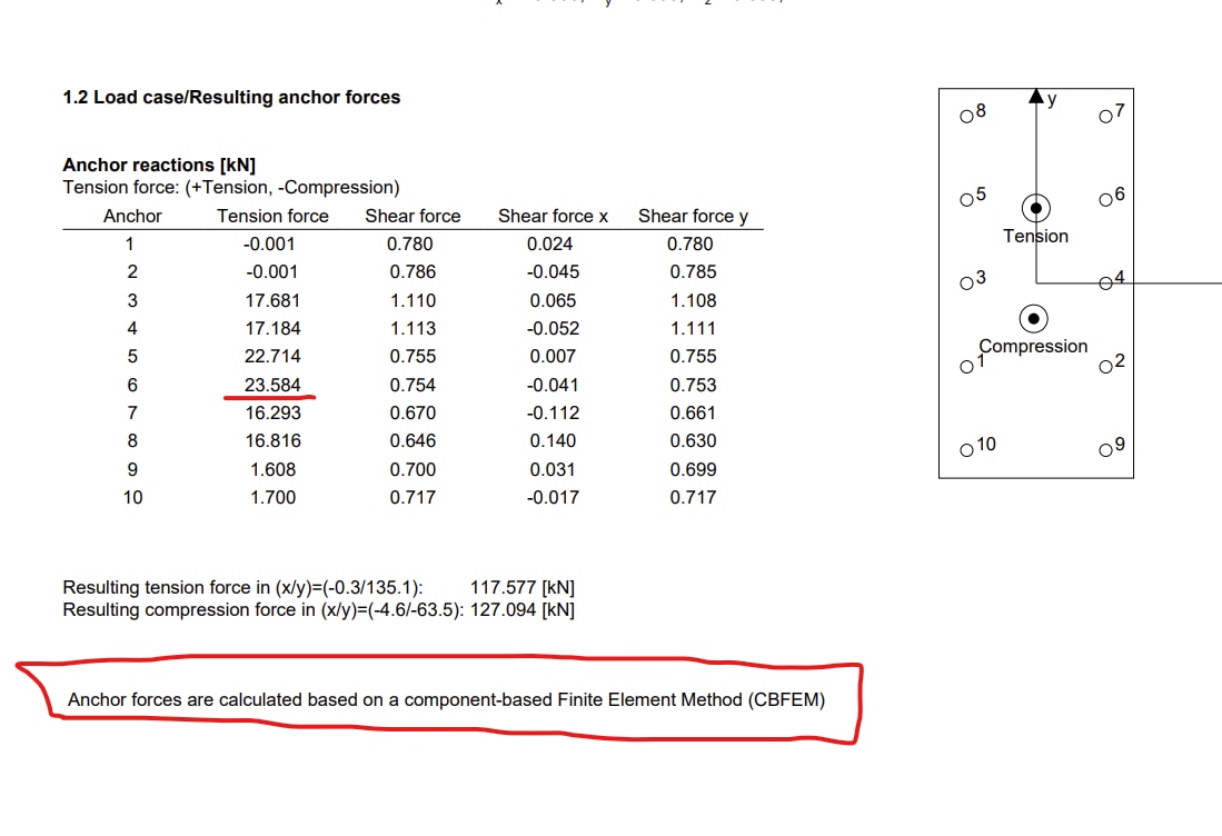

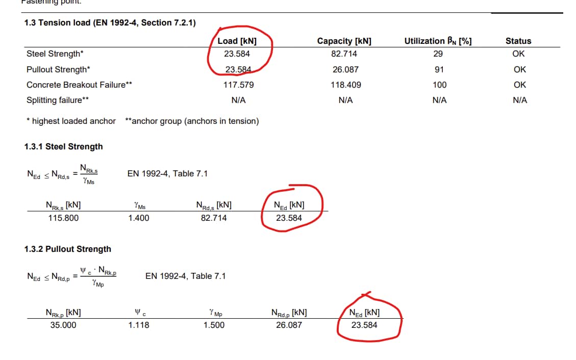

在应用CBFEM方法进行分析时,Report提示Bolt Design只在Base Plate为刚性条件下才正确,但Report里的Bolt计算都在CBFEM结果进行的,这是为什么?
Bolt Load,Rigid Plate

According to the anchor design standard, Profis verify the design under rigid plate assumption after CBFEM calculation, except the loading on each anchor, the reaction load calculated from CBFEM will be adopted since it should be more conservative and closer to the reality.
