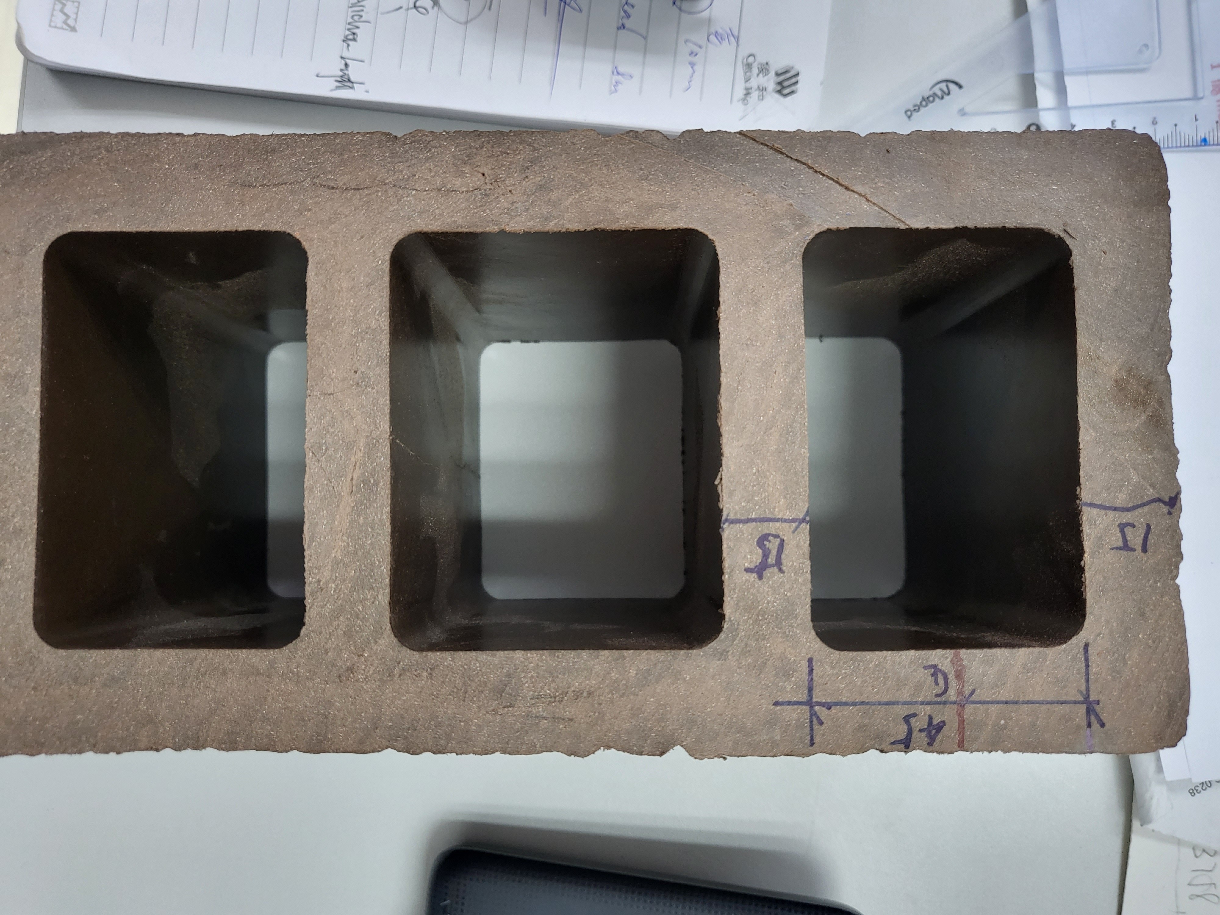

Question.3 Can the mentioned anchor bolt be applied 65x45mm in attached block section during the anchor extracted?

Question 3:
HHD-S can be applied on drywall and masonry. So, it should be applicable for your case. However, there are another considerations such as loading requirement and fixture thickness. You may find the details in the submission folder also.

Dear Daniel In the above cavity case (~16mm thk.wall), would you suggest the product, Sleeve anchor HLC-H 10x40/5 #385841 ( for solid wall case) or Cavity anchor HHD-S M8/24x66 #332074 or other anchor for the fixing work? BR Jacky Yeung
