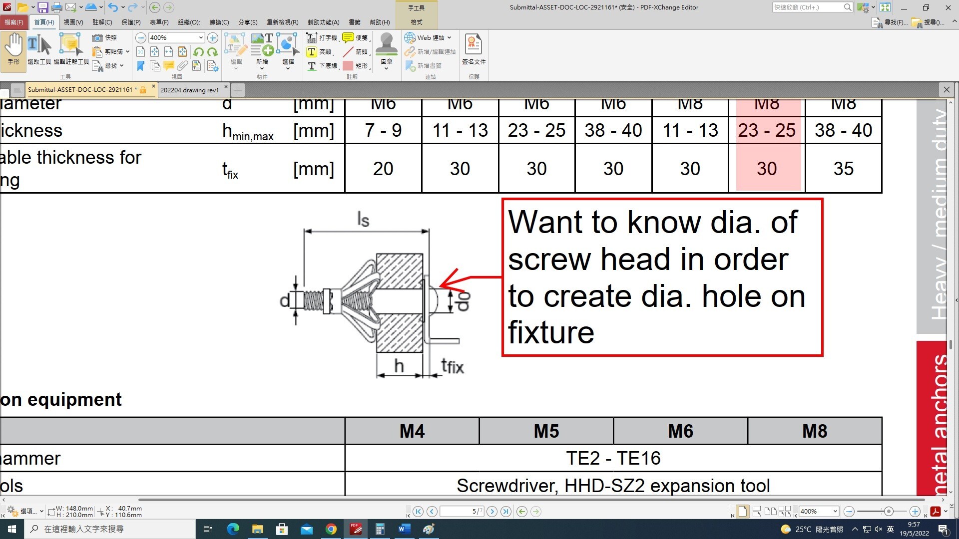

I decide to use Cavity anchor HHD-S M8/24x66 #332074 and now need to create the hole diameter for the tfix (the fixture). I need to know what is the diameter of screw head.

If you would like to check the drill hole diameter of the fixture, you may find the Nominal diameter of drill bit which is 12mm for HHD-S M8x24 on the setting details.
