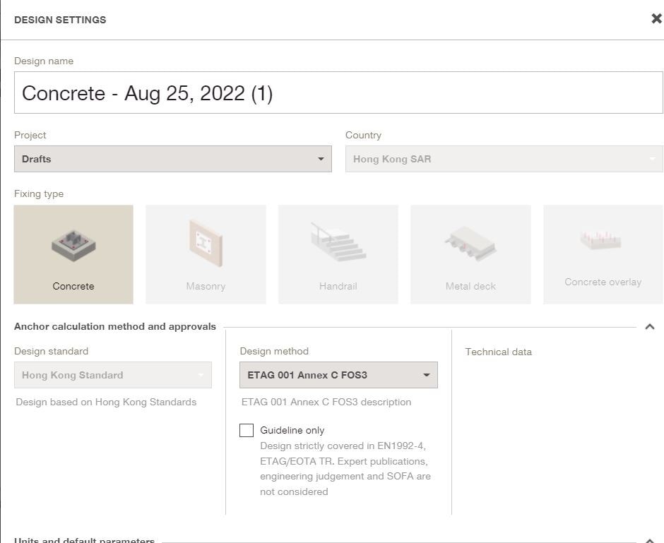

The Building Department is required safety factor of 3 for the anchor calculation. If your submission is required to submit to Building Department, then you need to apply safety factor of 3 in your calculation.
In our software "Profis Engineering", If you select the FOS 3 in the Design method, it is already including load factor = 2 and material factor = 1.5 in your design. You can directly input the working load after selecting the FOS3 method. (Please find the attachment for details)
Please feel free to contact us if any questions.
