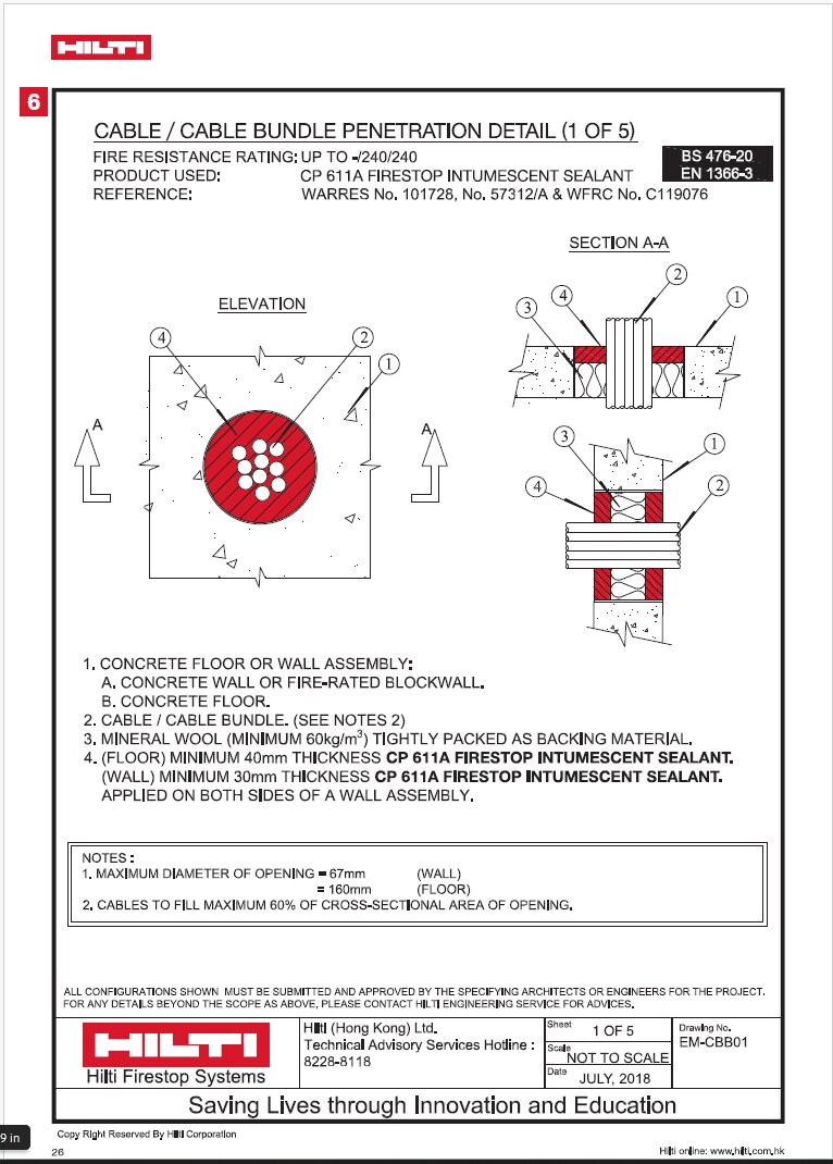

The talk sounds fantastic, and I plan to attend the next one on August 9. As for the discussion this afternoon, please share details about the fire stop application specifically for the space between cables, NOT the space between cables and openings. I am concerned about the possibility of smoke passing through the cable spacing. Thank you.

About your concern of the space between cables, please refer to the cable bundle penetration section and other cable penetration of our firestop application Handbook.
The following link give you the access to download the handbook.
UPDATES ON HILTI FIRESTOP APPLICATION HANDBOOK 7th EDITION - A...
In general, CP611A is adopted in conjunction with other products depends on the application.
Welcome to send us more detail for further assistance, such as the related smoke seal or air tightness standard for your concern.
