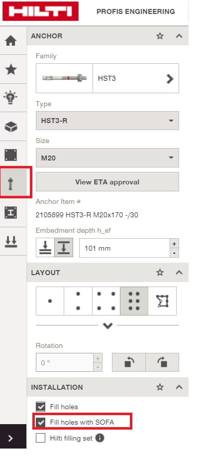

Update My Design or Delete Setting of Filled Annular Gap (SOFA)
Posted by Tony Lamabout 4 years ago
There is no SOFA requirement in HK code. How can I delete the SOFA setting?
anchor design,SOFA with fill
Posted by Lillian Wongabout 4 years ago
Hi Mr. Lam,
Thank you for your enquiry.
The SOFA function is for the anchor design configuration which out of the ETAG design method configuration, the SOFA function could allow you to continue for calculation.
If you would like to cancel the SOFA function, you could follow the attached capture screen for the unclick of SOFA setting.
Please feel free to contact us if any questions.
