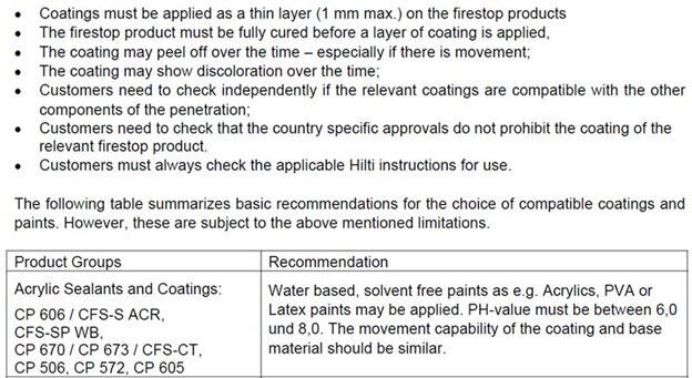

What type of paint can be applied over CP 606?
Posted by johnover 3 years ago
If contractor is required to apply epoxy paint on walls, what type of paint could we recommend for them to use.
protection,Firestop Product
Posted by Hilti Employee (lamder)over 3 years ago
Dear John,
Thank you for your enquiry. The printability of CP606 is subject to
limitations and the materials. You may find the attachment for your reference.
Please feel free to let us know if there is any question.
Regards,
HILTI (Hong Kong) LImited
